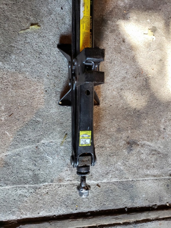

Message par Dave_Anne 2020-10-17, 19:07
I modified a small, easy to store scissors jack from a small Toyota.  Welded a nut with 19mm(3/4') flats to it so that I can use the Prolite provided stabilizer crank handle to operate the jack.  Now we have a lightweight jack available if ever needed.  It fits easily under the spring pads and works well.Jacking location Jack11

Jacking location Empty Re: Jacking location
Message par JLucV 2020-10-18, 08:16
@Dave_Anne You can find some jacks with 3/4 nuts in scrap yards for low price. Got some of them to install as stabilizers.

Message par Dave_Anne 2020-10-18, 16:29
Nice!  My jack was free, but missing the 19mm nut.  I have the same Mig welder, very handy device.
